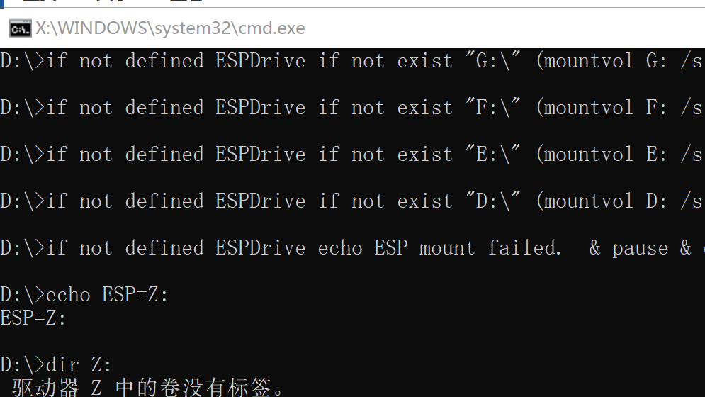

之前挂载ESP的命令(前贴)我在PE和Windows11下都试了,是正确的,为什么还要选择这么麻烦的方法?
  2. set "ESPDrive="
  3. for %%i in (Z Y X W V U T S R Q P O N M L K J I H G F E D) do if not defined ESPDrive if not exist "%%i:\" (
  4.     mountvol %%i: /s >nul 2>&1 && set "ESPDrive=%%i:"
  5. )
  6. if not defined ESPDrive echo ESP mount failed.&pause&exit /b
  7. echo ESP=%ESPDrive%
  8. pause
